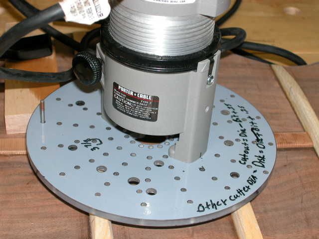

I second Lee Valley bits.They sell 1/16,3/32,1/8,3/16. They are worth every penny. Again, I sing the praises of the Jasper Circle jig- a baseplate with indexed pivot holes from about 3/4" to 7"-by using different bits as above and some simple math(printed on the packaging) you can rout just about any width of rosette.

I'll try to photo sometime today. I think Lee Valley sells them. I know that Woodcraft does-small pictures there.Usually $24.99,plus the old shipping, of course. It has a brilliantly simple centering device included. Remove the stock base on 310 and 2 holes already drilled in the jig line up. Spot punch and drill/countersink the third and as our Brit friends say "Bob's yer uncle." By the way, anyone who uses a 310 needs to look at Pat Warner,s site and also Micro-Fence.The M-F plunge base for a 310 will make you drool all over that spruce top you are routing-I think someone here got their circle jig-surgically precise and versatile. The Jasper only does circles -I just remembered;Google Jasper Jigs, they have their own site and the instructions are there as well as good photos. I did my very first rosette with the Jasper-purfling and abalone- maybe I should photo it so you can see how idiot proof it is!Miketobey38780.4966550926

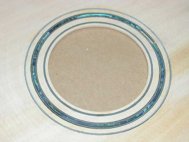

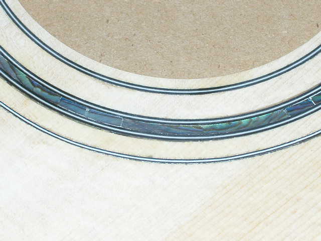

Explanation- first picture shows base with pivot pin -I just store it there-that would be around a 7" circle or disc.I wrote the alternate cutter formulas on it so it was always handy. Second is bottom view, of course. The screwhead with the little black dot by it is the added screw hole. The big arrows are for the supposedly universal mounting holes for routers-I think is is a 2 9/16 radius-I made some router tables for friends and used it with my Bosch 1618 VSS.And, of course, the others are my very first rosette and soundhole-somewhere I wrote down which bits and which settings for the pin-oh yes,on my workboard with the steel interchangeable center bushings. Now, isn't that idiot proof?*I can't tell what is going on here-i'm using the format. Miketobey38780.6002893519
